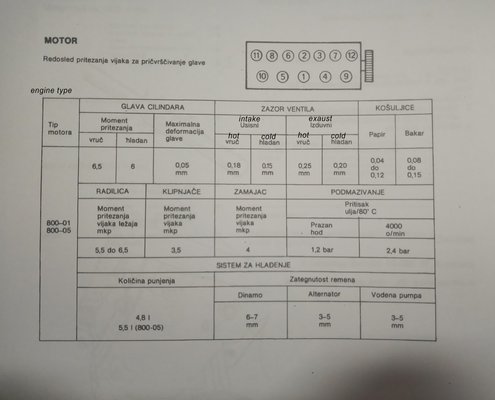

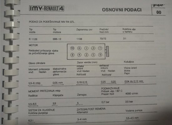

I have these tables in the Slovenian book, I don't know if it's your type of engine but hopefully will help with approximate values.

Hey Salamander1209! Thanks for your upload! I must admit my Slovenian is a little rusty haha, but I studied the images a little. I believe they do not give the values for the wear of the valve guides. Thanks anyway for your effort, much appreciated!
