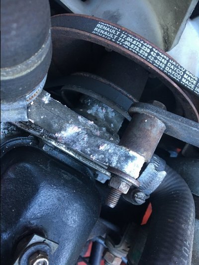

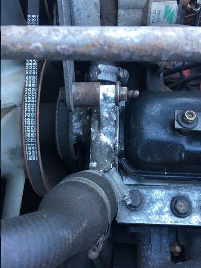

Hi I think I may have a leaky water pump. Cant find any obvious leaks from the hoses, but there is pink/white furring on the pump body - is this a sign it's the pump leaking?

Have you checked the upper rad hose? crystals forms and so can result in leakage between hose and wp... take off and clean off
any/all foreign matter before mounting back on.. -Reid
