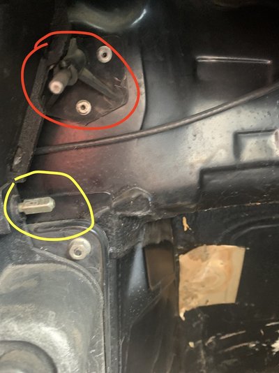

I don't drive the R4 all the time as it lives in France so I don't know what these do on the heater box
The circled red bit seems to open and close a flap to divert air?
The thing circled in yellow seems to have lost its handle? Very hard to move with my fingers, what does it do?
Thx
N
Hi
The one circled in red is to open/close the air vent flap. From outside of vehicle, you have the black grille under the windscreen, the flap lives behind the grille. The one circled in yellow is to actuate the flap on the heater and direct the air flow. Both knobs are missing.
Hmm, when I operate the red one I get a massive air flow up the demisters!
If I want cool outside air I lift the 'ashtray' lid in front of the steering wheel, there is another one on the passenger side and air comes out of that.
I definitely need to find a knob for the heater flap

Does anyone know where I might find Part 3, the handle for directing air up or down?
That should be a bar projecting out of the bulkhead, which you push or pull to operate. It should have a hard rubber button but these often perish, and I replaced mine with a same size hard plastic one which works a lot better.
The device which changes air flow from up to down is the handle I really want, marked as 3 on the manual above
