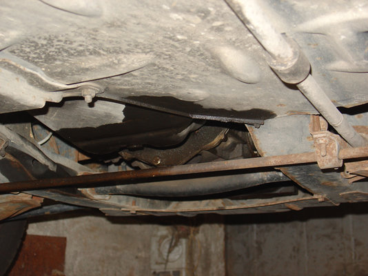

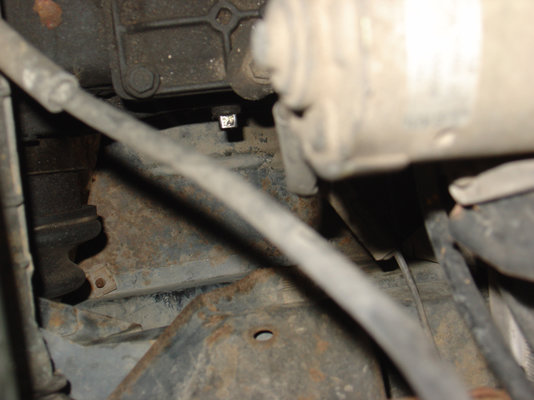

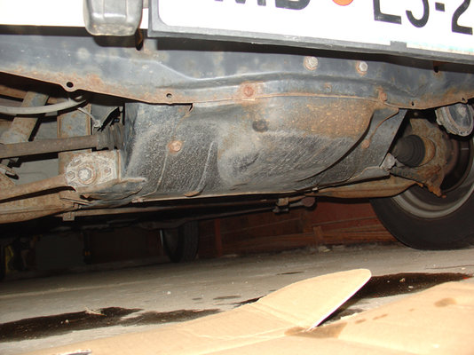

I have a metal plate screw'n down there it just and by the drain plug. I didn't have time today to do a picture, will do I tomorrow or the day after.
Here you go, here are the picture. It took me a while, but here they are.
On one you can see the filler plug snapped from above and there's a plate underneath, so you can't see the ground.
Second is made from front, directly in the plate.
And the last is mad from the back side, so you can see the oil drain plug and how far this plate goes back. It end near the drain plug for the gearbox.

Thanks for posting the photos - I now know what you meant about the metal plate - I should have realised, sorry:oops:
I would remove the metal plate - it comes off very easily on our GTL.
Good luck!
No need to apologize, I can speak/write english quite good, but when it comes to technical stuff I'm stuck.
Tnx for the help. I'm going remove it, when I do the oil change.
