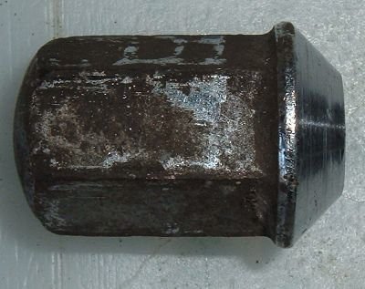

Funny old things aren't they - very long taper. Alloys are normally centred by the hub and have flat wheelnuts. These are clearly centred by the nuts so have really big tapers to spread the load on the Alloy. Probably used on the R5 only.
Might be worth a wanted ad on Andrew's Renault 5 site http://www.r5gordini.info/xml/ForSale/ForSale.php?Category=4
Otherwise have you tried Renault for prices.

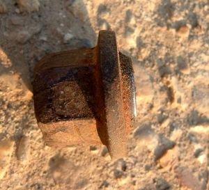

.........I am using my original wheel nuts on my Gordini wheels...and the wheels havent fallen off ...yet
If anything the studs are a little too short but my 'you'll never get quicker than a quick fit fitter' said they are fine and that if the wheels fell off, it would only be one at a time and I would probably notice a slight problem with steering the car in a straight line - mind you I do have that problem all the time...
Sounds like we need a production run. Anyone got a lathe?
Anyway, here's a pic of a standard wheelnut which I think will confirm, when compared to the Gordini wheelnut, that Ian is completely and utterly mad. :eek:
Srew them on tight enough and they'll probably not fall off, but you'd probably get wheel balance problems and might damage the lovely Gordini alloys.

If you need to get some made, the taper is 45 degrees, thread size M10, bolt size 17mm, and the shiny face that contacts the wheel is 6mm long. The photo should be good enough to check dimensions.
