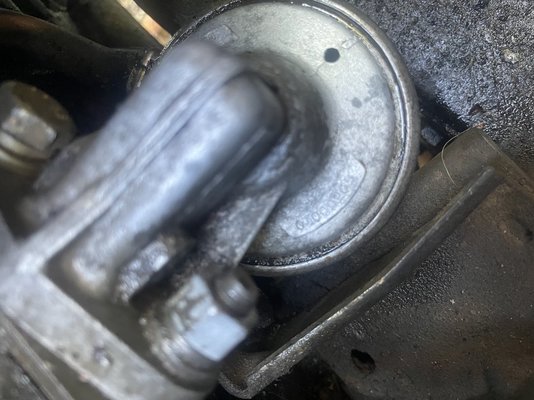

Hi all, it has been a while since i posted anything, as all has been good with my F6 1100cc van.
Recently fitted a new mechanical Fuel pump as there was a starting issue and i noticed fuel spitting out of a little hole on top of the fuel pump (see picture). I assumed this was a pressure relief system of some sort and thought the pump was coming to the end of it’s life.
So ordered a new one.
Now installed, but can only get the engine to run with full choke, and obviously high revs, but the moment i try to push the choke in ! The engine immediately stops (have tried pumping the throttle to over ride the choke, but it is almost impossible to keep it running; also a lot of White smoke billowing out of exhaust.
There was a 50% - 50% chance i had accidentally put two stroke fuel in the fuel tank as i was also messing around with my wife's (two stroke) scooter at the same time.
So i have drained the fuel tank and replaced with fresh fuel (+ Wynn’s lead additive;-) but still getting the same white smoke and will only kind of run on high revs with full choke and with tons of white smoke from the exhaust.
Any ideas would be most appreciated guys.
Thanks guys.
Jeff
(My F6 is using the standard 28IF Carburettor, still using “Points and a Condenser in the distributor “)
