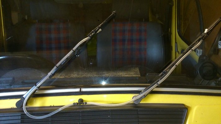

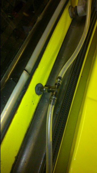

Hi, I removed the washer jet, it was useless, and heat hardened hose and started again. New hose, but I fitted a rubber grommet to the hole in the scuttle. I passed the hose through it and fitted a tee-piece. Then I fitted two hoses to that and fastened them with cable ties to the wiper arms and blades, making sure there was enough slack for the sweep of the blades. I then used a hose connector cut in half at the end of each hose, and finished off by pushing the tee-piece through the grommet. This works a treat, not original but what the heck! I can post a photo if that would help.

Hi Brian
Be interested to see a picture of what you did please

Hi Tom, I'm just going to try to download a couple of pictures. By the way, the parts for this little job came from Holden Vintage and Classic. DSC_0270.JPG DSC_0272.JPG I'm not sure what the purists amongst us will make of this, but it works well.

Hi Brian
Thanks for pictures.
Interesting arrangement certainly

Yes, not to everyone's taste. Holden do a nice range of washer jets too if you want to be more original.
