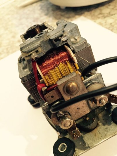

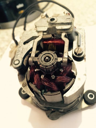

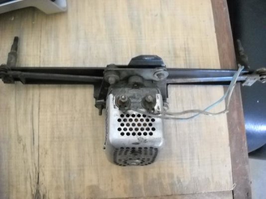

Here I am again in need of help. My wiper motor does not work, just makes a "click" when receives power on any of both wires.
I have opened it and found that the click comes from a moving part on the right side of the motor (see picture attached), After some cleaning of the collector and spring replace, the motor spins a few degrees but that is all.
At the same time it can be seen a tiny spark on one of the carbons (Is that the name?) were it touches the collector (Left side).
To me, the rotor seems to be too close to the frame (Left side) even tough it does not shows signs of a rubbing zone, is it normal?. Does it need a stronger spring or new carbons or ????. :confused:

I can see from the photo that the tension spring for the brushes is hooked directly on both of them. This is wrong, as it will make a short-circuit and won't allow current to reach the collector. One end of the spring was originally connected to the brush by a little plastic hook to prevent this happening, and that's what you must try to do (I use a small zip-tie).
The whole right part (as on your photo) of the stator pivots so as to contact the armature when the wipers reach the park position, and act as a brake so they stop moving immediately. So don't be surprised if you see these parts touching each other at rest.
I can't remember exactly how this "brake" is released (I think by electromagnetic force?). Check that it pivots freely, and also that the collector is clean. Your brushes are OK, no need to replace them.
Should check the spindles that the wiper arms are attached to are not seized. They normally come free with a lot of heat but if they are seized they will stop the motor from turning.

Thanks a lot for your prompt response. Actually I have noticed such pivoting part, moved by an electromagnetic mechanism. You can see it at the bottom of the picture. I will isolate the brushes as suggested.
On the other part, I wiil check if arms are seized. They feel a bit hard to move. Actually they haven't move since I purchased the car back in 2007 and who knows since when were they not moving for the previous owner.

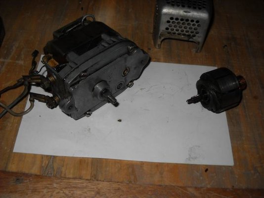

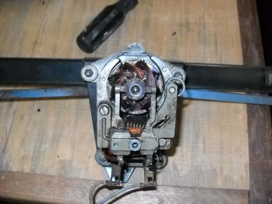

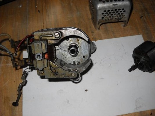

I have disassembled the whole thing today and tested for the arms mechanism seizing and they were not. So I tested the motor without it and It didn't work,
I went further away and unhook the rotor. Found some greasy dirt, tested the gear reducer, and It was working properly, I mean, not seized.
After that, oiled the pinion which looked a bit dry and tested the motor again. It did a better effort to start spinning with no success. So I put a little bit more pressure on the brushes with my fingers and Worked!!!!!!! :o
So, the issue is fixed. I will install a stronger spring ensured that it is well isolated from the positive side of the brushes. The whole mechanism has been lubricated.
Thanks a lot Angel and Malcolm. Have a nice day :)
