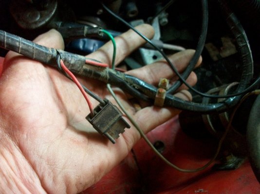

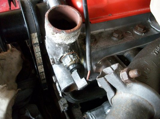

I've sent you 2 photos. The first shows the connection at the waterpump. The thin red wire is encased in a black tube. It travels over the top of the engine.
in the second photo you can see the black tube at the tip of my middle finger. You can see all the wires are then taped together and travel behind the engine and then to the back of the instrument panel.
The green wire, top left, is from the oil pressure sensor, and this also joins in to the taped batch
Good luck!
