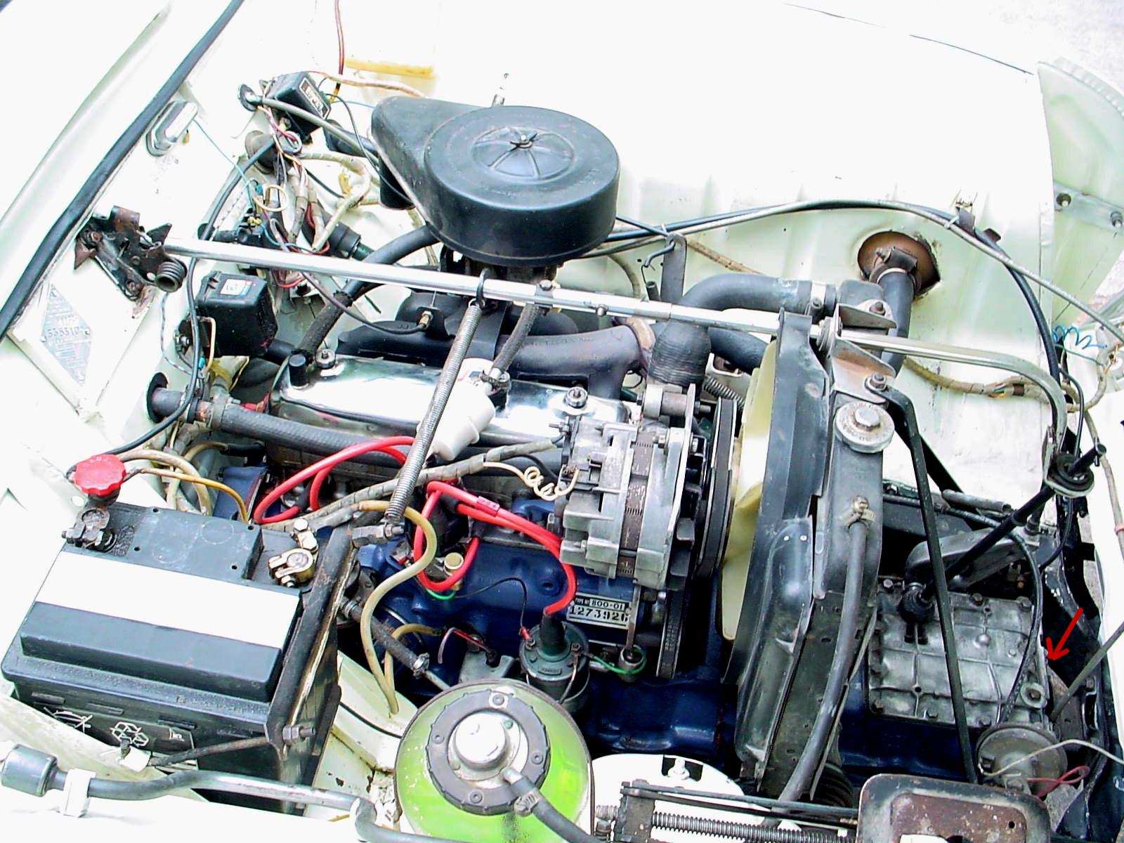

Hi Cili! One more suggestion: It is very rare to have an oil leak from the speedo cable seal because it is located higher than the oil level. First check that the oil level is OK (oil just overflowing from the plug at the gearbox side, car on level ground). Check also the gearbox breather, it is located very close to the speedo cable. It should be clear, and as you say that the problem exists on hot days, it may be clogged with muck, so pressure rises inside the gearbox forcing oil out of the seals.

A very easy way to overfill: Fill the gearbox with the car tilting to the left. That's why all manuals say again and again "the car should stand on level ground".Anyway, I still suspect the breather. It looks like a small cap,don't try to find a tube, it is actually a tube with a small cap over it. Muck gets between the orifice and the cap and clogs it.It is located on the top of the front cover exactly where the arrow on the photo points. I could not find a better way, you have also the chance to take a look on my '75 R4s engine back in September 2002...

thanks very much for the new reply and the pic. Even though the engine of my R4 looks a bit different (for es. the radiator is much more ahead exactly as the battery) it's very helpful to identify the breather location.
