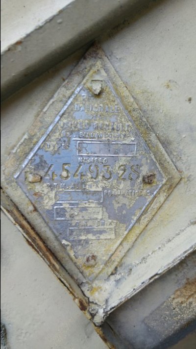

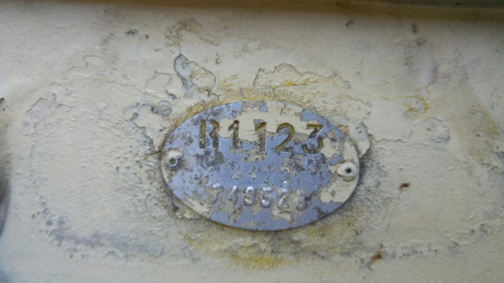

Adolfo Salazar Pávisic New Member Messages 1 Location Viña del Mar, Chile May 17, 2018 #1 Hi everyone! I bought a R4L and I wanna know the year of consturction. There is a list with frame's number and years? Please help me with this. Thanks!!!
harbourseal Renault R4 Lunatic Messages 1,049 Location Breda The Netherlands May 18, 2018 #2 Nice 4L This one is from between 1961 and 1967 I don’t know if anyone made a list with vin numbers and year of manufacturing.
Andy McGhee Enthusiast Messages 1,834 Location Cheltenham May 18, 2018 #3 Lovely car! The Renault parts book (PR900) gives these numbers for the R1123: 1963: 1 1964: 75092 1965: 158639 1966: 217549 1967: 319789 1968: 463622 1969: 627132 1970: 765582 1971: 931590 1972: 1077043 Hope this helps.
