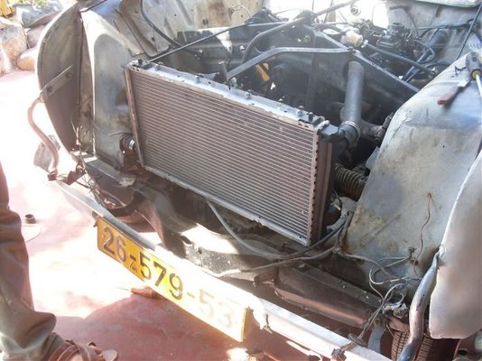

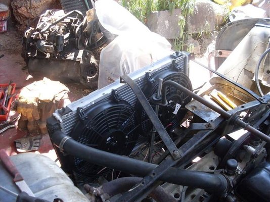

Although we have wider radiator with two fans, most of the engines are boiling in extreme temperatures (35C+).
So I fitted a Citroen C15 Diesel radiator, wich is much wider, with two flat fans.
