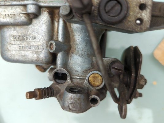

Pictures of other 28IF's I’ve seen show 2 brass discs whereas mine only has one. Am I missing one, and does it matter? you'll spot that the +/- 5mm brass tube for the dizzy vacuum is also missing but I’m searching for one of those.

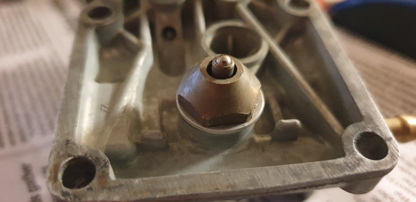

The fuel inlet valve (controlled by the float) in the carb flops about and is not backed by a spring. It just flops in when you invert the carb. Should it be spring loaded?

The float doesn't have a spring. When the bowl is full, the float rises and cuts off further fuel entering the bowl.

Any ideas about the (possible) missing brass disc in pic 2, or is this normal ?
This brass disc is a plug for the idle circuit gallery and must certainly be there. Now your idle circuit is off, that's why the idle mixture screw is turned so far out and still has no effect.
You should have such a disc fabricated out of brass or aluminium and press it in the hole in order to have a fully functional carburettor again.
