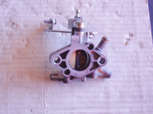

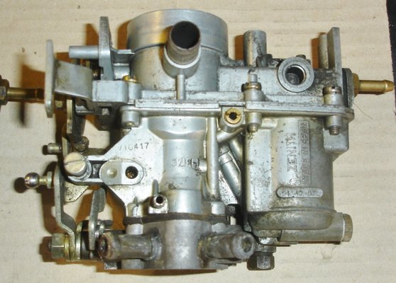

Gave the carb a 'first' clean to get rid of some of the dirt.

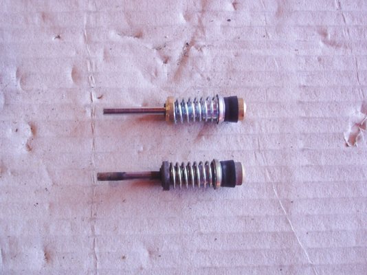

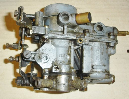

Had obtained another 32IF 7 carb as a 'spare' but this was a V10410 model with certain differences.

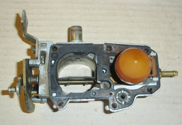

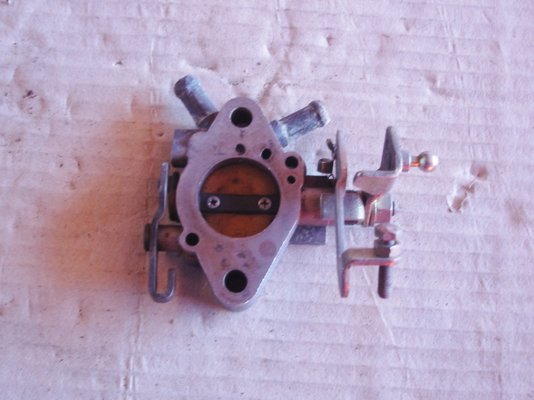

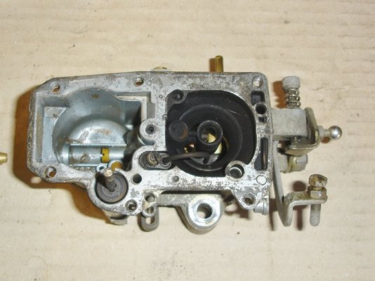

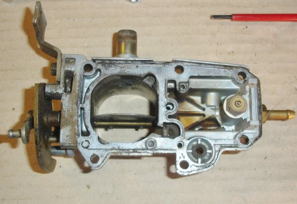

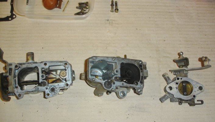

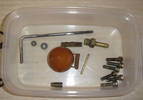

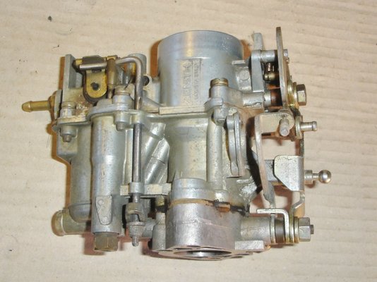

Some pictures from splitting the carb into 3 main pieces:-
