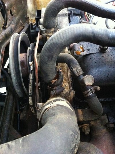

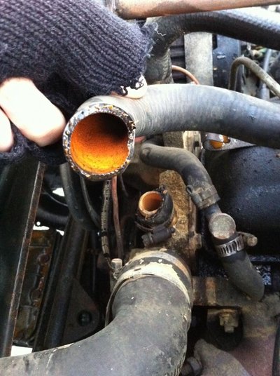

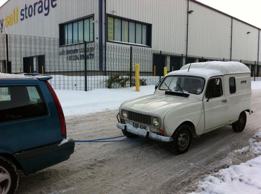

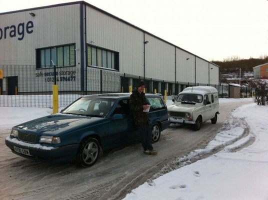

Set off this morning at 7.45am, giving myself enough time to defrost the car and be on my way. Put the keys in and VROOM! Off we went. Driving along and I thought something was up, there seemed to be a strong smell of rubber but I couldn't put my finger on it. Then, 2 mils in, all of a sudden ¡¡KA-THUD!! Sounded like something fell off the car, a big bit of snow? I stopped, got out and walked round to the front. Damn! I could see orange water all over the white white snow! It didn't look good. Being relatively mechanically inept I rang Bobble to ask his advice, all the while hoping that I hadn't done anything to the head gasket. With some reassurance Bobble suggested that it may be a burst pipe. So after a brief look at the engine I wondered how I managed to miss the mother of all broken pipes. Not only had it burst and dumped all of the water down the road, it seemed to have warped the fan belt. Bugger. Time to call for rescue. My friend came out in his Volvo 850 to give me a hand and after a quite trip to B&Q, to buy a tow rope, we pulled Bertie out of the Aberdeenshire wilderness and back to civilisation.
She is resting for the rest of tonight. I have cut the bad bit of pipe off and reattached the remaining part back onto the engine. The fan belt may have been warped by the water, then again it is in pretty bad shape and does need replacing. I think a chat with Bobble is needed to learn how to put blood back into The Miracle Whip and bleed her.

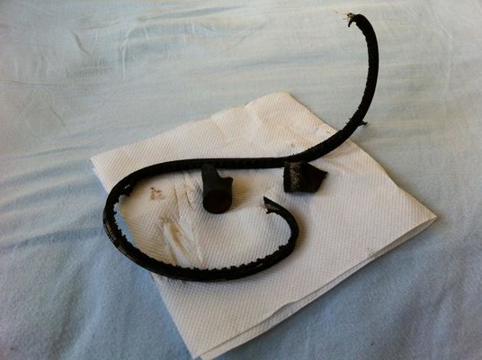

Water pump siezed up, due to not enough antifreeze, hence the belt snapping, me thinks.
Bugger...
Ah, the belt snapped first!
That fits with Bobble's new 'frozen fan belt and not getting pumped water' theory.
Could be Reggie, but i usually run all our cars ( and the boys ) with 50/50 antifreeze/water winter and summer ( but -16 could be stretching it ) he did say there was a strange smell and then a ka-thump so assumed the belt had frozen to the pulleys and when he started it the crankshaft chewed it's way through the belt and snapped it leading up to overheating and then taking the easiest or weakest point of escape fragile water pipe.
Now he has to renew both belts ( which i did tell him to do couple of months ago ) fill up with water and try it first to make sure everything is alright before draining again and then add antifreeze ( maybe a bit stronger this time ) also told him bleeding the system is a pain in the neck, but 500 miles is a bit far to pop over and help.
Have you checked the head gasket, as this is normally the cause of burst pipes (I had a spate of them about five years ago and eventually tracked it down to the head gasket - new gasket and skim and all was well). I would not have thought anything would have frozen or burst with a 50:50 mixture. In 1982 I started my R4 in a temperature of minus 21 (Uk's coldest day at the time) and no butst pipes then.
GTLs are prone to head gasket failures as the cylinder head bolts are only barely adequate and need regular torquing.
From the colour of the rusty water in the second photo I'm with reggie with freezing. Bottom hose off, drain the rusty water out, then refill with 50% antifreeze (should work out about 33% given you can't drain the whole system that way).
Freezing can cause all sorts of trouble - I reckon that's what cracked the cylinder head on the Gordini. You might find you now have a bit of trouble, but getting antifreeze in quickly might help avoid worse trouble.
