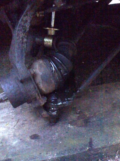

While changing my brake discs I somehow managed to damage the rubber UJ gaiter.:eek:
Furthermore, after removing the hub nut I noticed sections of the thread were slightly chewed.
Basically I want to replace the drive shaft and change the wheel bearings (sand blew into the grease). Replacing the gaiter looks quite tricky. And probably isn't wise given the iffy thread.
What are the differences in R4 drive shafts? is there a difference between TL and GTL? RHD and LHD?
And most importantly does anyone have one for sale?? I can collect easily in the Midland / southern area.

Everything after 1973 is the same, be it R4, R5 Mk1 or R6, left or right side. So you will have no problem finding one.
The outer gaiter is rather tricky to replace, as you guessed. It can be done from the gearbox end of the driveshaft after first removing that UJ.
I have a home made cone device for putting drive shaft gaiters on - makes it quite easy to do after taking the outer joint apart which isn't too bad (Note to self and others!: Invert the gaiter and pull it down the cone!)
How bad is the thread is the portion where the nut normally sits when done up damaged ?

The drive shaft also "bowed" slightly off centre when rotated. It might have had a knock in the past, as the front outrigger is a bit bent on this side. It's a good opportunity to put my mind to rest and get a new one.

Thanks for the cv boot advice, maybe not such a struggle as I originally thought. However one ring of thread on the hub nut section is damaged and the shaft is slightly bowed so I think I'll still look for a replacement.
