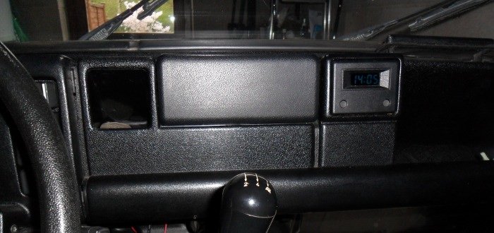

I suggest that you find another source off continuous power. I tapped the wire for the clock.
:rolleyes: "...the clock" ? Wow, tell me more. Is this a super deluxe version you have godlike ?
It's a normal GTL build in Slovenia in 1992.
Look at my photo album in my profile. There's a picture with the radio and on that one you can see the clock right of the gears.
The first one's have had a normal clock, this one is digital.
Our 1990 Slovenian-built LHD GTL has a digital clock too!
