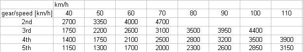

I managed to find a transmission ratio for 4-speed gearbox that goes into the R4 and 5-speed gearbox that goes into R5 (old) and I have a theoretical RPMs each gear at certain cruising speed.
The situation is like this
Gearbox from R4 HAO-146
and with this gearbox engin should theoretically run at RPMs
Gearbox from R5 HA1-01-G or HA1-02-D
First three gears are identical, 4th is slightly shorter, and 5th is little longer.
Performance when starting the vehicle and driving up hill would not be changed, but will get lower RPMs at higher speeds.
This is just what I am looking for, to lower RPMs while driving magistral roads at speeds 90-100 km/h.
To me, this gearbox would fit R4 engine perfectlly (maximum torque at 2500o/min, maximum power 4000o/min), but still would like to hear other opinion.
And if someone has their own experience that would be great!
I'm afraid that car could lose "breath" at some point while driving the car when changing gears. All these figures give me conclusion that this case might occur when changing from 4th to 5th gear. 4th would have much RPMs and 5th little RPMs.
Is there someone here on this forum that has fit 5-speed gearbox into normal, standard R4 GTL, can you share your experience with us?

Looking at the whole thing in the round, the 4 speed GTL gearbox will do it all.
At 70mph, the 4 speed is at 2,150 rpm, the 5 speed 2,000rpm. Who cares about the small difference of 150 rpm?

Politeperson may have misread the data tables - they're in Km/h not MPH.
Nonetheless, his point about the small difference in rpm remains valid.
However at 100 km/h that difference of 250 rpm drops the revs below 3000. At around this point the engine is getting into it's power range and there's a big increase in fuel consumption. For steady cruising down the motorway it would be nice to have the engine sit just below that boundary.

I am talking about km/h not mph. It is big difference. But your point is right. Difference is only 200-250RPM if we compare 4th gear on 4speedgearbox, and 5th gear on 5speedgearbox
But i had deferent logic while i was doing comparison:
On normal R4 GTL i am changing from 3rd to 4th gear at 70km/h and RPM are dropping form 3100 to 2150. Sometimes i go up to 80km/h but rarely (if I am taking over someone). And then i am cruising 90-100km/h at 2800-3100RPM.
If i go to 5speed gearbox, situation is like this
On 70km/h i am changing to 4th gear and dropping from 3100 to 2500RPM, then speeding up till 90km/h and changing from 4th to 5th gear and dropping RPM from 3200 to 2600
and after that i am cruising on 90-100km/h at 2600-2850 RPM, quite below 3000 RPM
Also, GTL's engine has highest torque at 2500RPM so it would be better if engine is spinning somewhere around that number.
