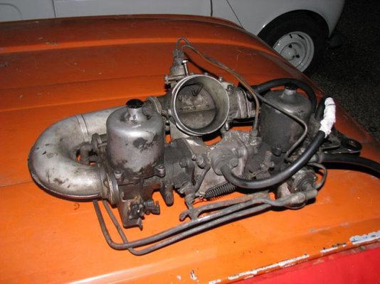

Sorry a bit off topic, I had a quick look on the forums and couldn't find much about the SU conversion. Any chance of a pic ?

I've got pictures but won't be able to upload them until Monday, sorry. It's a manifold and SU off of a Reliant, practically bolts right on. Faces toward the bulkhead.

I've attached a picture :D.

An 1 1/2 SU would probably do the trick on a 1108cc engine, although the Reliant inlet manifold would need a modification to fit it I think. I wonder if there is a way of fitting twin SUs? Of course there is, anything is possible, but then, sometimes a well tuned bigger single carb is better than smaller twins.
I think Bisons' and his pal Daves' cars had 1 1/4 SUs fitted if Im not very much mistaken, to quote a Murrey Walkerism.
Maybe one would work but 2?

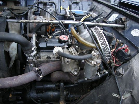

+Sorry kind of hijacked this tread, would a good test be after a run run bolt the exhaust from the manifold and see if its black in there ?

I'm an SU fan as well. What kind of Reliant did the manifold come off?
Thanks for posting the photo Malcolm.
The Ali manifold is from any Reliant three wheeler, or the little 4 wheeler I think, as is the carb. Yep, it's 1. 1/4", same jetting/needle, in fact all I did was clean the float bowl and fit it, then adjust the main jet a little, works great. Put two T 's in place of the parallel pipes in the heater hoses for the water heated part.
Before I got the Reliant assembly I made a simple manifold for another SU I had, so making one for a GTL should be easy, how about a 45 or 90 degree plumbing fitting?, and perhaps an SU for an 1100 mini might have close jetting?. Just a thought.
