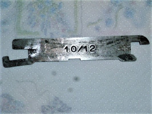

Hi All,
My GTL has failed its Control Technique road test with a below par front right drum brake reading. On inspection (again) all I can find is what appears to be a bent cross piece (from shoe to shoe) and, on magnifying glass inspection, a stress crack in the part.
All the usual suppliers do not list this piece as available. Does anyone out there have one lying about that I could buy please?
Attached photo is of the piece.
Thanks for looking
I would not think that is the cause of low brake pressure ,more likely a stuck wheel cylinder or glazed shoes, you could straighten that and weld the split and replace the wheel cylinder ,or you can buy a complet brake kit including that piece and have new brakes both sides.
Above part now straightened and crack welded and filed as good as new, Brake shoes are brand new, wheel cylinder, brand new, brake fluid drained and replaced with new, brakes properly bled. I have ordered a set of new springs etc, watch this space
