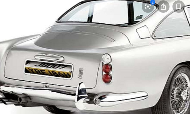

Im tempted to do similar but I gather should you have an accident and someone notices your plates i think your insurance would be invalid? Some forums suggest thisJim, I like your strategy. Alternatively, has anyone considered a Northern Ireland registration? For less than £140 (inclusive of transfer and VAT) you can get a relatively anonymous, non-dating plate (such as NXZ 4491) from one of the many on-line specialists offering this service.
That’s a good thought and a good opinion. I remember the yellow and white being introduced. And yes it was for visibility and safety not ANPR which of course was not in existence then. My first car a Morris Minor Reg TTL262 I swapped the black and white plates for white and yellow to pimp it up ! Ironically The guy who bought it ( by then it was an even worse wreck) bought it for its registration. Got an Mot on it and sold the Reg for a lot of money . But now I’d love to go the other way and put black an white plates onI think the yellow/white plates are reflective and they were introduced around 1967/68 on grounds of safety (although the original raised plastic characters on reflective film stuck to aluminium are still much better at reflecting than the more modern acrylic plates). I remember articles in AA Drive magazine extolling the safety benefits of such plates, not too mention adverts in car mags of the day.
I think it's odd when so many people with pre 1973 cars simply have to swap to black/silver, any they accept the modern (2001 on) narrow font. Back in the day from the late 'Sixties many (half?) new and older cars had reflective plates - even some cars with a pre-suffix registration.
I actually think many cars look better with reflective plates of the plastic characters on aluminium type, even if they could have black/silver. It's probably more original too, since anything post c1968 may well have had them from new.
