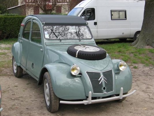

Hello all,
I don't know if this was an R4 option but I have seen a picture (which I can't find now!) showing an R4 with the bonnet mounted spare. So I ran across the 2CV Sahara with a reassessed hole for the spare (see below) and I was wondering if there is enough space between the bonnet and engine/aircleaner to drop a hole to place the spare inside?
Since I am a Land Rover owner I am particular to this set up, and I think it would look great on a Sinpar R4...:D

I think the bonnet is not strong enough... I have seen somewhere a picture of an r4 (maybe modified for a 4L trophy) whit the spare on the bonnet, but I think this would include a structural work on the other side...
Some one has his spare wheel on the rear bonnet, but others said the hinges are not strong enough too...

Cool... I wonder if they placed any reinforcement under the spare. From pictures of bonnets that I have seen, I can tell that there is a beam support around where this spare is.
So if one cuts out a hole (drops the metal then welds a band (plus supports)) to make the spare fit into the hole... how deep can that hole be?
How much space is there between the mechanicals and under the bonnet?

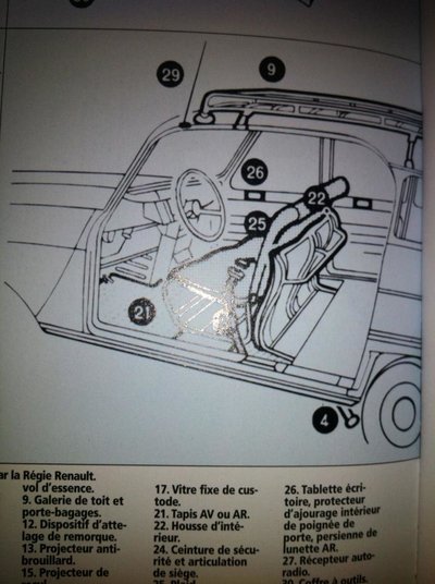

Does anyone have a picture of this type of roof rack that was available for the R4? Here is a drawing from the #37 Gazoline magazine
I have in my garage a roof rack from Fiat 500. After that we used it on R4 and on a Zastava 101
The roof racks are available for a classic roof rack company. a friend of mine restores type2 and type3 vw campers for a living and he is always putting these little racks on them.
Search for companies like retro racks but beware they are not cheap.
