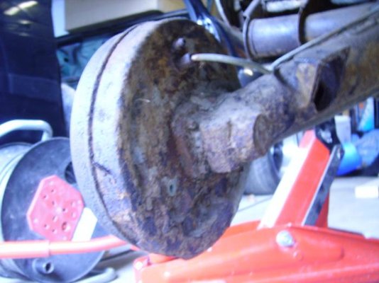

One very rusty backplate - not nice.
The source of my problem. Beyond restoration. :(

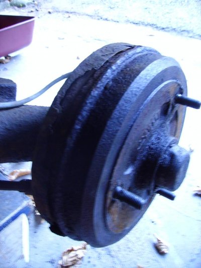

Just this one. The other is solid all round.
To Sage of Torphichen
That part of the back plate is just to keep dust and muck out. If the main part of the backplate is ok, ie where the brake shoes are mounted I would then just cut a neat patch and weld it. Even if it is just a temporary measure.
