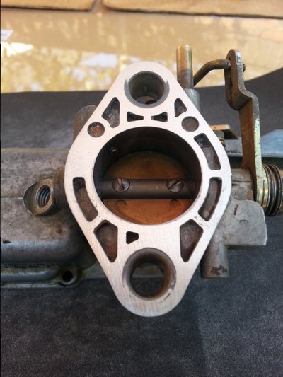

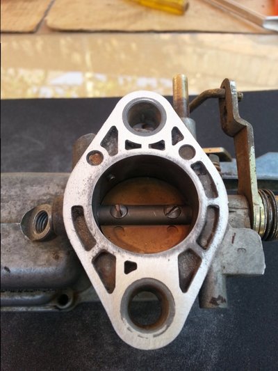

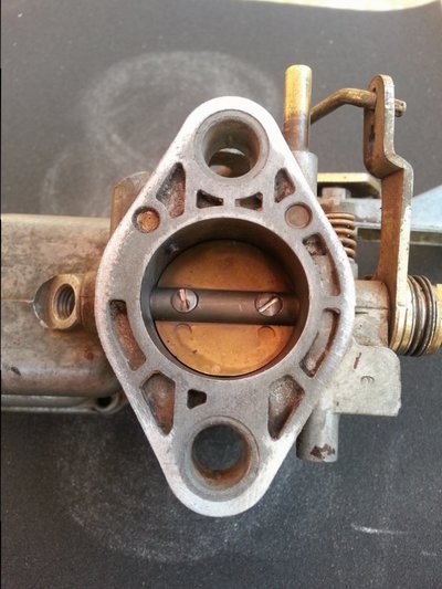

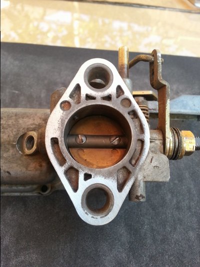

The most common issues, with the old original carbs at the long term, is that false air is sucked in from somewhere.
Gasket replacement by use of a revision kit, may help, but the most likely problem is a crooked basefoot at the aluminium underside of the carb caused by overtightening the nuts.
The base foot can be easily flattened by sanding in an eight-figure movement. Use a glass plate for a flat surface and sandpaper grid 250-400.
