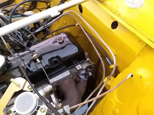

I am in the middle of fully reconditioning my R4 braking system, and I have just fitted a new master cylinder. Although I still can't workout how the bulkhead brake pipes are routed/secured ? I have looked at other R4 bulkhead photos online but still can't see how they are routed/secured ? Thanks20231210_074021.jpg20231210_074101.jpg
I am in the middle of fully reconditioning my R4 braking system, and I have just fitted a new master cylinder. Although I still can't workout how the bulkhead brake pipes are routed/secured ? I have looked at other R4 bulkhead photos online but still can't see how they are routed/secured ? ThanksView attachment 32495View attachment 32496
Good morning the pipes on my 86 GTL RHD drop straight down from the m/cyl one goes round the back of the engine on top of the chassis lip another goes down the side of the chassis under the right sill not easy to explain but had to do them when the engine was out all held in place with strange plastic clips your picture looks nothing like the original you would need the original pipes to be able to replicate the system as Renault did it hope this helps a bit. Gerald

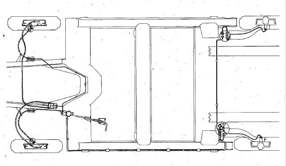

Indeed from the main brake cylinder straight down just as MR175 shows (attached picture brake circuit with hand brake on front drum brakes. On GTL's (and later TL's) with front disc brakes the hand brake is on the rear drum brakes.
Hello Gerald, Many thanks for this useful info, so it looks like the previous owner routed the pipes in the wrong place completely after restoring the car. So I will remove them and look for the original route over the chassis. Cheers.

Hello, Many thanks for this useful info, I will remove the pipes that the previous owner installed, and look for the original route over the chassis. All the Best. Kevin

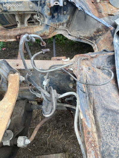

As the picture shows it is around the lip at the bottom of the engine sump then across the lip underneath the wing and down the side of the car underneath the sill (left or right side depending on car)
OMG ! It looks virtually impossible to fix the brake pipe on top of the chassis with the engine in ! So I can see why the previous owner routed the pipes like he did. I have some nice metal double brake pipe clips, so I will do a neat modification and fit them on the bulkhead. Not original but it will be a good mod.

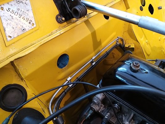

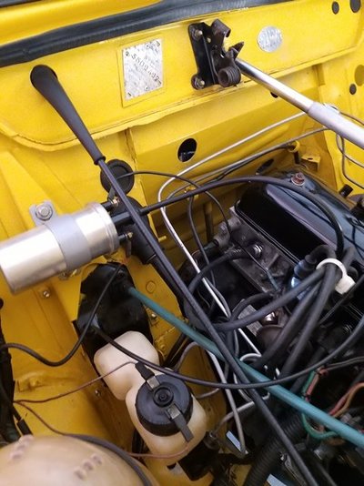

Well I fixed the brake pipe routing problem today, okay it's not original but it looks neat and is easy to access. Does anyone know what that small bracket in the photo with the hole in is for ? 20231211_121507.jpg
The small bracket with the hole on the right side of the photo is a throttle cable mounting for LHD cars. It wasn't normally fitted to RHD cars made in France, but yours might have been made somewhere else.

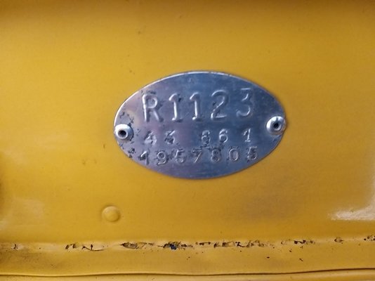

The diamond plate reads R1123 - this is from an 845cc car - and is fixed on the bulkhead boss for a rectangular plate. The holes for the LHD parts look to be there and plugged. It is what I suspected - a re-shelled chassis. Can you please post pictures of the oval plate, and also the rear part of the crossmember where the seats are bolted on? We may be able to clarify what's going on.
Thanks Angelos, I think it is a LHD converted from various NOS parts.20231212_081425.jpg20231212_081609.jpg
Oval plate is from a Cyprian market RHD 1978 TL.

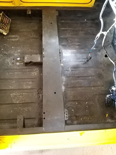

If you have, or you can take, a picture from the rear part of that crossmember - imagine what the toes of the rear passengers "see" - it will be clear whether the chassis came from the TL or they changed it with the bodyshell.
Yes you are correct Angelos ! And I just found a body number stamped on the righthand side of the crossmember as well R1123 5809492 which is the same as the bulkhead plate, so it's a 1978 Renault 4TL RHD body, with a post 1983 bulkhead (later dash) and LHD chassis (brake pipe on L/H side) with a rear handbrake, disc brakes, Amil alloys, 688/D7 1108cc engine and a sunroof ! AMEN ! So all I need now is a decent RHD post 1983 dashboard. Thanks.
Wait, I asked you for a photo because I suspect that chassis number only may had been transferred on a later chassis. Front torsion bar anchor points will tell us the truth.
Also I see you have internal door hinges and small tailgate hinges, so whole bodyshell is post-83.
