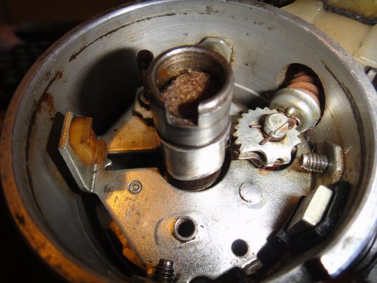

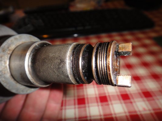

After a years search I have finally found the correct dizzy but the centre column is a bit stiff. I know you need to put the oil but where ?
Its totally sealed as far as i can see.
Looked as Haynes ...no help really.
During regular maintenance of distributors you are supposed to put oil in the sponge in the center of the column, were the rotor goes.
In this situation I think that a complete dismounting of the distributor and a rebuild after cleaning and lubricating is really needed.
Brilliant. A litttle oil in the sponge it will be.
I am a little worried about taking apart. For instance the serated wheel that regulates the vacuum. In hayes it says only get a qualified engineer to regulate this.

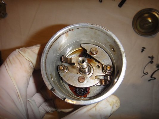

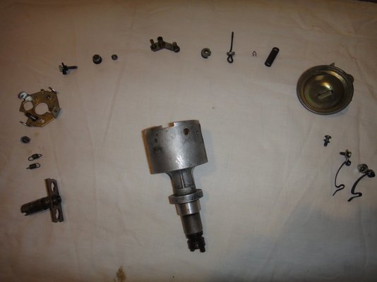

I have taken the plunge and took the whole thing apart. I still couldnt get any oil into the axle bit.
Took photos before dissasembly.
The serated wheel I put back at notch number 4;)
put it all back together. There was a bevelled washer in there somewhere that I wasnt sure but got it right.
Blew air into the Vaccuum.
Do you know there is a pin size whole in it. I didnt but I do now. Almost bought a new vacuum.

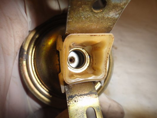

I decided to completely dissasembly and re oil the dizzy (and de-oil so its dry inside after, too much oil not good). See photo
I am glad I did because I found a problem by accident that would , if not noticed, have made the whole advance/vacuum redundant.

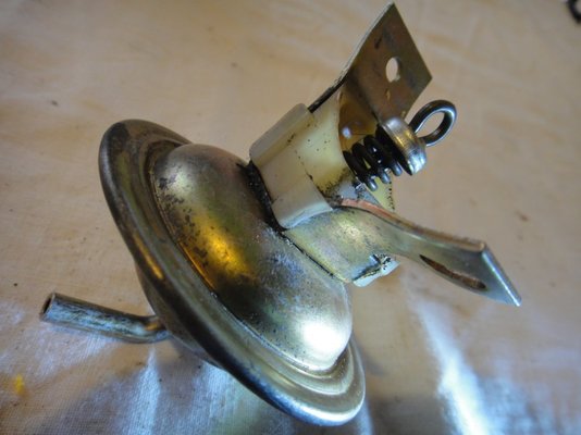

on dismantleing and removing the vaccum from the main dizzy it came straight off leaving the arm (and spring) pointing out the side of the dizzy. Thjs I found out later should not of happened.
There is an arm (and spring) that connects the serated wheel to the diaphram inside the vacuum.
This arm has a screw thread on the end that goes into the vacuum and this obviously must be screwed into the diaphram inside. See photo
This enables the the vacuum to pull the diaphram then the rod then alter the dwell on the serated wheel. (makes it go in and out)
Mine was not screwed in. Therefore meaning the whole diaphram would not pull the arm and therfore not adjust the advance.
I would never have known what was wrong had i not opened it all up.
To replace, I know now, that the arm and spring must be attached to the vaccuum bell and then re-attach it to the main dizzy unit and then the serated wheel.

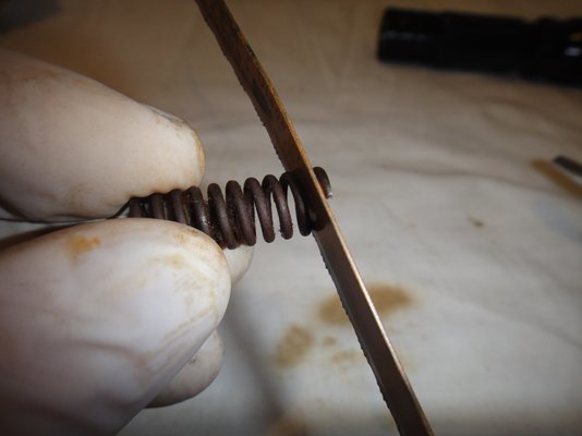

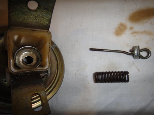

Spring was too big.
Meaning unable to screw rod into thread inside Vaccuum. (See Photo)
Cut spring down smaller.
With spring smaller able to attach arm and screw into Vacuum.
