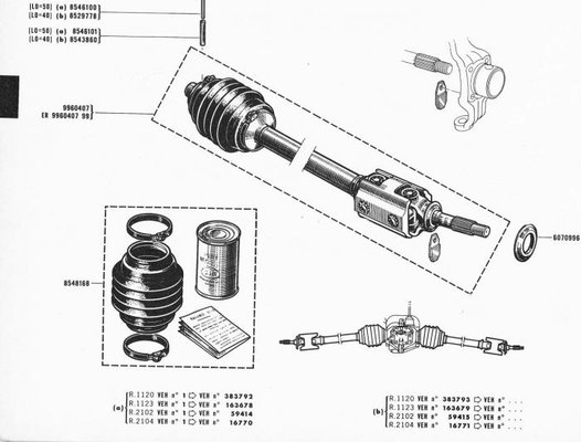

This is the one I'm after, however investigating having mine repaired (if possible) the gearbox end boots are history, the left shaft has later boot, the buggered one has cylinder type boot with clip that looks like it is designed to never be put back on again.
Manual shows this one but size. hmm
