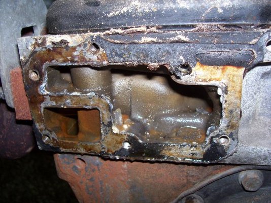

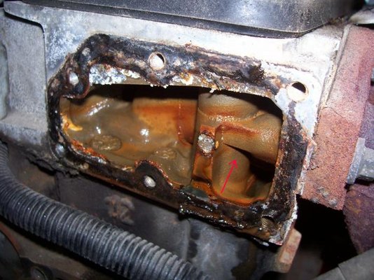

Easy answer for an Unleaded Head ?
Yes - it's bound to have unleaded seats but not sure if it's suitable as the water pump is at the 'wrong' end. Maybe it can be converted by swapping the pump and the blanking plate. Not sure but it's worth a try.
Apart from the easy water pump / blanking plate swapping, one must weld and machine the blenking plate side of the head to form the "separation wall"...may be cheaper to install hardened valve seats in a GTL head!
