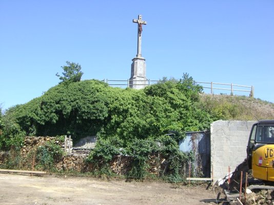

..But today is the first day of our Eco house building project at Mareuil..
..I would like to keep this thread updated on progress, so bear with me and here is our site a while ago..

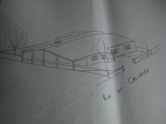

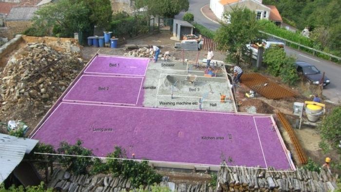

Here is roughly what I am aiming for - Looks a bit dull I know but as we are within 400 metres of the church and right under the Calvaire, we are not allowed to do something out of the ordinary - It has to be 'traditional'!!
It also seems to be bent I know but I couldn't get the plan to lay flat for a pic this morning!!

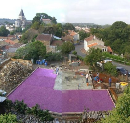

..Foundations nearly finished..
..And all service pipes are now installed - For your interest, the purple colour is anti termite treatment - an absolute 'must' in France now..
The first pic looks odd as I have merged two pics - The other is self explanatory I hope!!

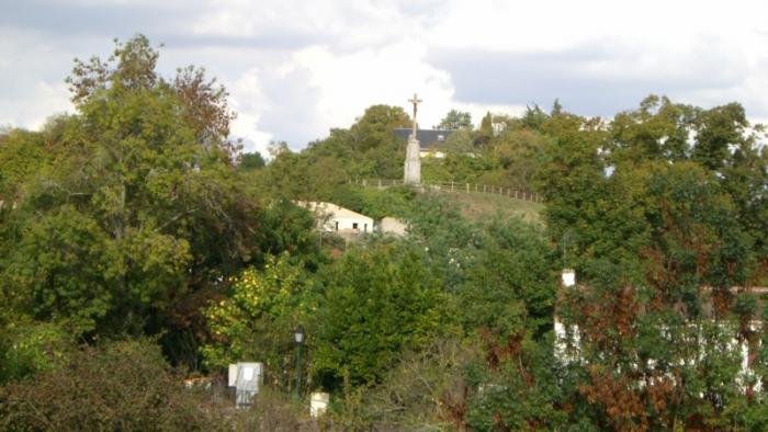

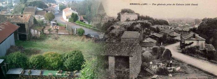

..I really needed to start at the beginning didnt I..?
..Well here is the site circa 1920 merged in with the site circa 2007 - Notice any similarities?

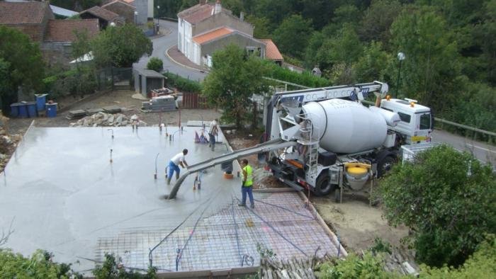

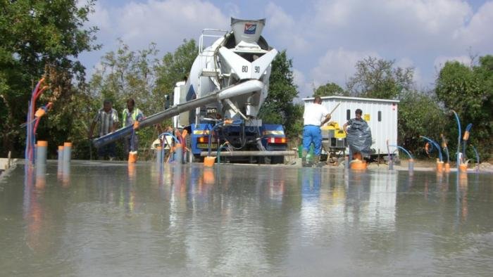

..Slab now done and dusted - 22nd September 09..
..And it all went swimmingly - Horray
In another 3 weeks, a house will appear as out of the ether, so watch this space!!

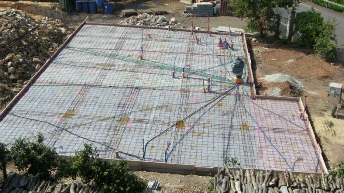

The first pic shows all the electrical conduit in place and then all the self levelling screed arrived - Its so easy in comparison to traditional hand applied screed!!

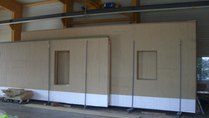

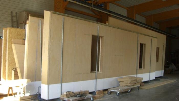

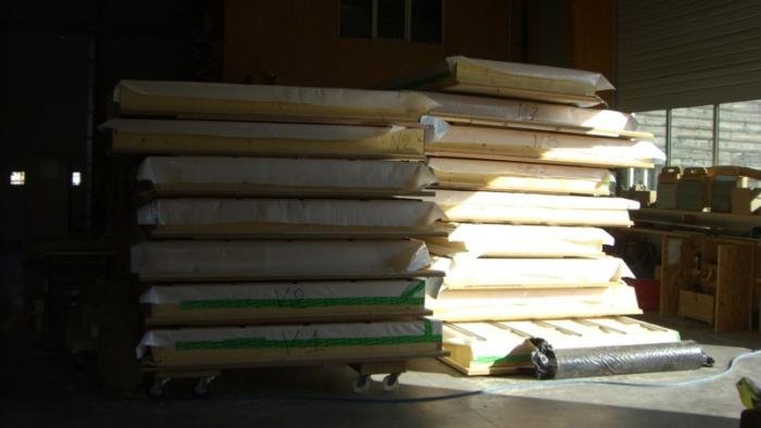

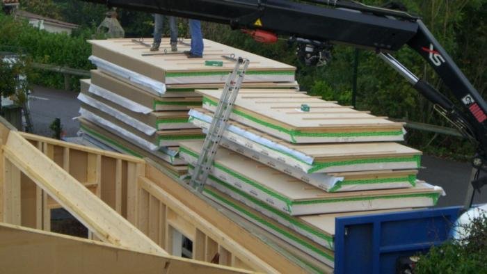

..A bit spookey..
..Seeing the walls and roof sections in a pile on the floor and in large racks.

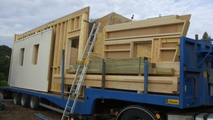

We were told yesterday that they will all be loaded on to a very large lorry and delivered to site on Monday week and by the end of that week there will be a house on site, so continue to watch this space, if you are not too bored with looking at it - this 'space' that is.

What are the walls made of? Is the insulation already in/on them? What are you using for generating electricity?
..Hello Mr Blacksmith..
..And do you live in Wassenaar like my friends Beth and Peter?
Thanks for your interest in my little project - The walls are made of 150mm studs in filled with high density 'laine de bois' - Wood Wool (made in Germany)
On the outside of the wood studs is a 50mm layer of dense fibreboard - again made in Germany. The wall will be finished with some stuff called Storender - colour to be decided.

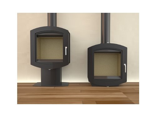

To all intents and purposes, sadly it will look like a traditional French house but will be really well insulated - The house will be heated by this English Firebelly Firepod 5 kW wood burning stove (www.firebellystoves.com).
In the roof space, there will be a heat distribution system that picks up heat from the wood burner area and distributes it all round the house.
That's it - no other sort of heating at all!!

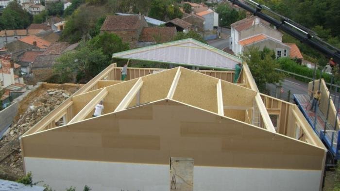

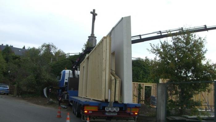

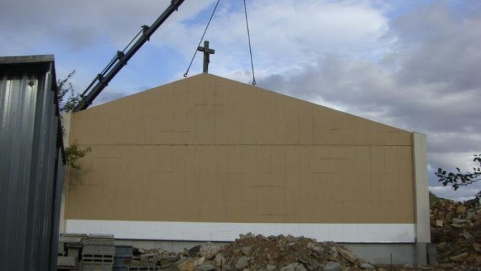

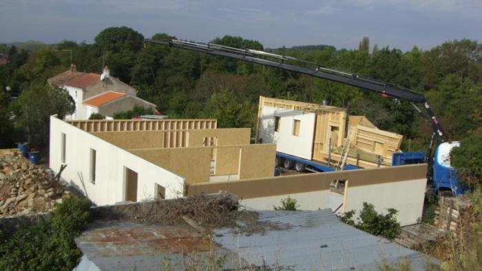

..Well team, the Ikea lorry has arrived on site today..
..And it all is going spliffingly well..

Flimpin eck, you can get some idea of the scale it with the lorry next to it, its going to be quite a large house when its finsihed.

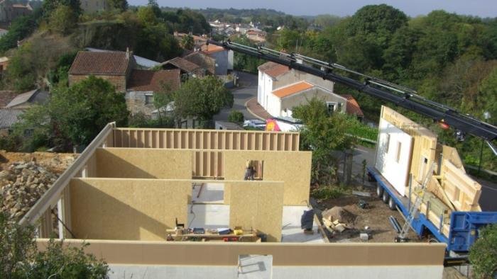

..And its beginning to look like a house..
..And this is what we have at 6pm French time tonight, with the added advantage of someone very special looking over and after us..

Not bad for a days work. It's amazing how the flat pack houses go up.

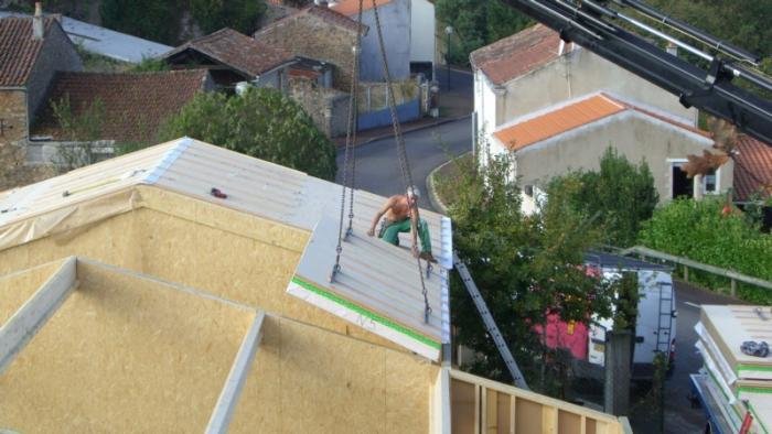

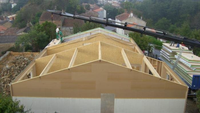

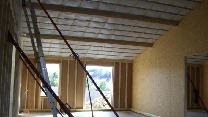

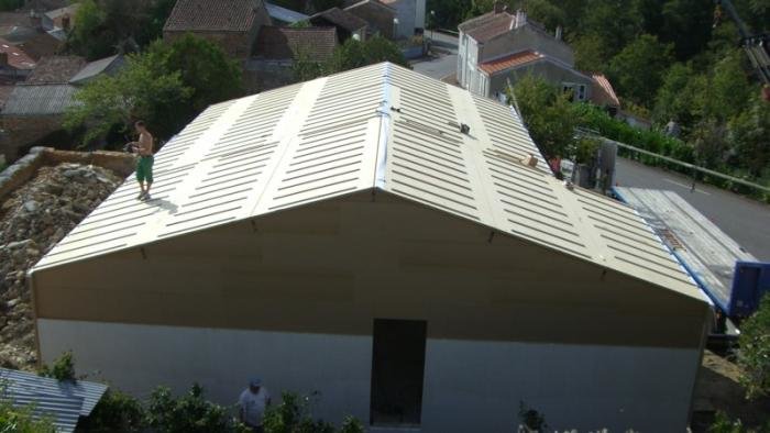

..Well the roof is now on..
.. So we now have ourselves a house..!!
