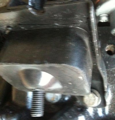

I've got new engine mounts for my 1108cc. The right hand mount (pictured) looks like it is secured by four bolts but as shown, at least one of these will not line up. Am I doing something wrong? Are all four bolts required? Any advice much appreciated.

Take it off and slot it then put in back on. Job done!
I bought some for an 850 from Franzose, needed to redrill one as the holes were not exact, did the trick.
Maybe you're in the same situation?
Bon chance
