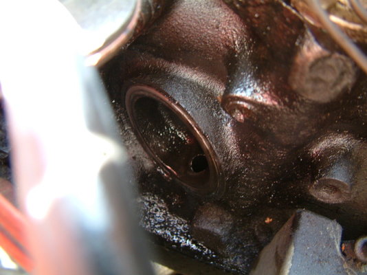

Hi all
I live in France and have just this weekend bought a 1980 F4 Fourgonette.I've decided to give it a service and have found it doesn't have an oil filter!!Where it should be (under the fuel pump) there is just a sort of what looks to be a blanking plate with a sort of bolt head.Is this some sort of anomoly?is it an internal oil filter of some sort and if I was to unscrew it would the thread be there for a canister filter.Hope someone knows something!!I've attached a photo of the "part"
Thanks very much.

That's very strange. Looks like you don't have an oil filter at all just now. Probably you can unscrew it and replace it with the ordinary canister filter.
Keep an eye on the oil pressure - only part of the oil goes through the filter so just possbily it was blanked off to try to increase oil pressure (although it shouldn't make a lot of difference).
I thought it was strange also.I'll pick up a filter tomorrow and give it a go(although I don't know how I'll keep an eye on the oil pressure!!!)
Thanks again
Paul
Oil pressure probably won't be a problem. The only indictor on the 4 is a low pressure warning light that might come on at hot idle if the pressure is a bit low. Thes are hardy engines operating at low power so don't tend to have problems.
More likely someone was halfway through an oil change and found they'd bought the wrong filter.

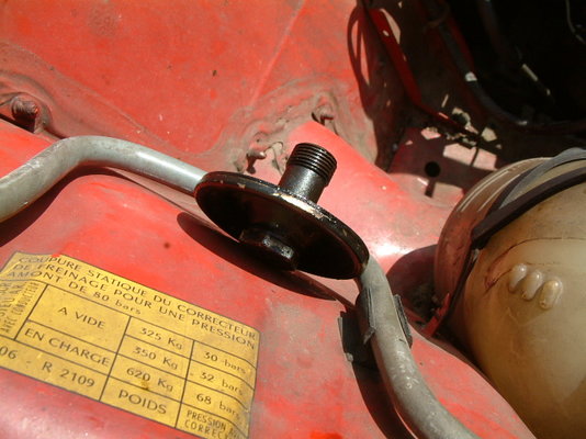

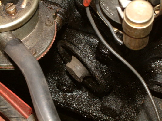

So I gave her an oil change, air filter, spark plugs(gap(0.6) was spot-on) and went to fit oil filter.No chance.Took off blanking plate and instead of a male thread to connect my 15 euro!!! oil filter to I find it's the blanking plate that has the male thread(pics attached).So needless to say the blanking plate is back on!So no idea what I'll do for an oil filter.

That blanking plate is a cost saving measure used to delete the oil filter on certain models of the three and five main bearing motors. I’ve only ever seen them in parts catalogues and from memory they were only used on the French market versions. Overall it probably cost more to make a separate blanking plate and plug than just provide a filter! At least there is a provision for an oil filter on your three bearing motor :-).
There is a hollow threaded piece that screws into the block providing a thread for the filter to screw onto that can be purchased from Renault (or pinched from a scrappy). The part number is 7700556153, this is for the early 3/4" (19mm) thread extension. Renault changed from the 3/4" (19mm) thread to a 20mm thread in around 1983, so you will have to obtain a threaded piece from a pre 1983 motor for your 1980 car. However, there is also a double ended threaded piece that is 19mm on one end and 20mm on the other end, that was used on early type 19mm blocks and allowed them to take the late type 20mm filters. If you are lucky you may find one of these, as they will allow you to use the late type filter which may be more common or cheaper. I’ll post up the part number for the double ender later on when I have it to hand.
Once you have obtained your threaded piece, make sure that you have the right filter. A late type 20mm filter screws loosely onto a 19mm thread extension, but it WILL come loose. So if you have a 19mm thread, make sure that you have an 19mm early type filter.

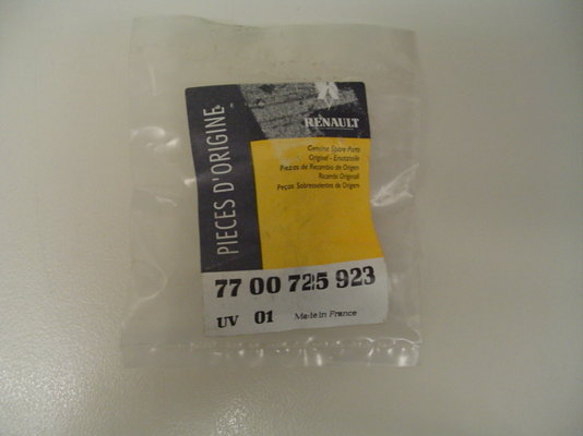

Hi Jenx, I used to work for Renault in France during the mid to late 80's, Its an addiction you never lose !!!!!!!!! I have encountered this before and ther is a simple remedy. Depending on your oval number and engine code, there is a double threaded adaptor, the part numbers are as follows, Internal thread 19mm, 9151668680, just under £5, int thread 20mm, 7700727684, under £5, and 7700725923, again 19mm, but slightly longer, That one is around £16. If you can give me your numbers, I should be able to tell you which one it is. As for your clutch, I can get hold of a full 3 piece kit from Renault for under £60, again according to your numbers, it should be either 7711134049 or ends in 48. If you have any problems or they are much dearer in France, I come over to get 4 and 5 mk 1 bits every six weeks or so, Hope this helps, Chris, TRACBAR245. Ps checkout Mike from Spains oild 4, now named FIFI

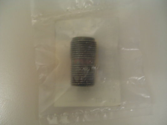

The part number 7700725923 is the double ended 19/20mm adaptor (see attached pics). Probably the best solution as it allows you to use the later oil filter which may be more common. I bought my adaptor from Marchants Garage in Tunbridge Wells (are they the same as Whitehorse Renault?) for my other car when the 19mm filters become less common.
