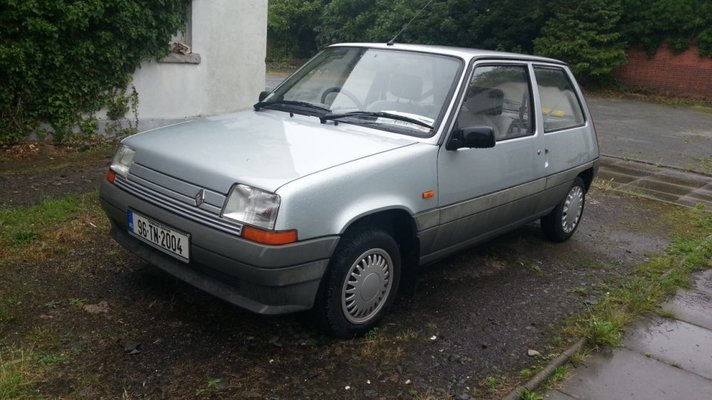

Here's another photo of the R5:

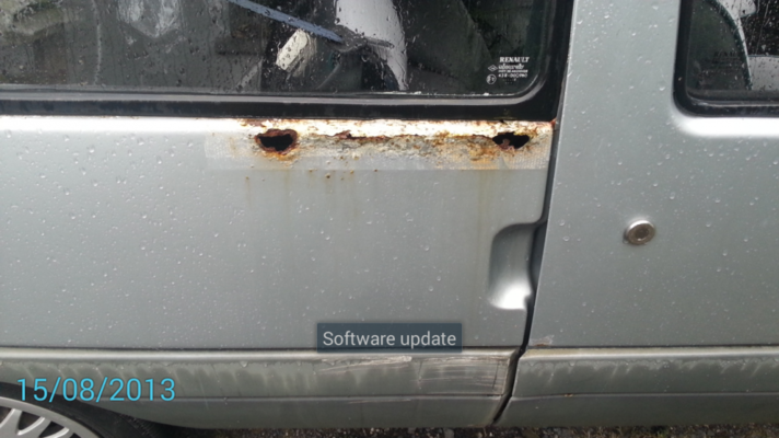

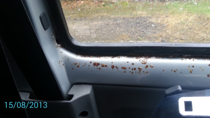

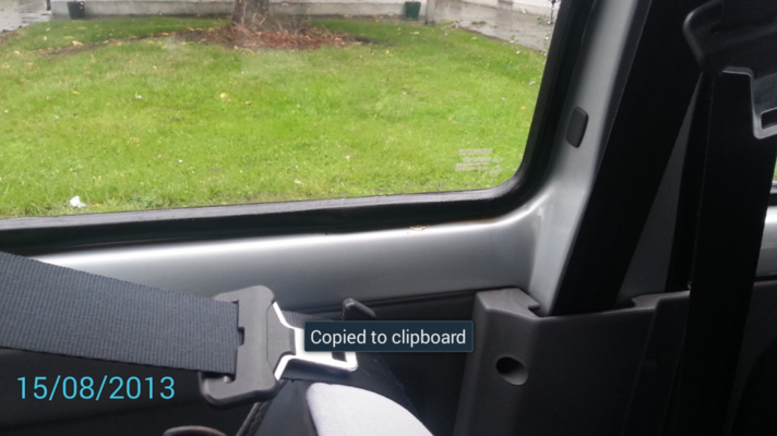

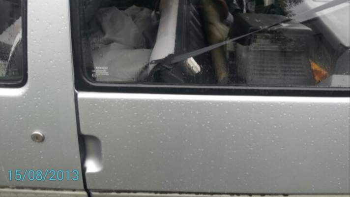

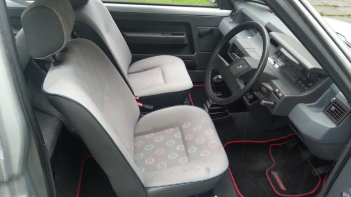

20130815_144723.jpg 20130815_144705.jpg 20130815_144705.jpg 20130815_144723.jpg Snap! I'm lucky enough to have one too. Haven't driven it for two years. It's in a friend's barn. Less than 16k miles, but one rear quarter panel has rusted under the window. Anyone else have this problem? Is it difficult to repair? I'd love to get it back on the road. Here are some pics
It's fixable. Remove the window and the interior trim panel, cut out the rusty metal and weld new metal in. I did that to the inside part of Bobble's R5 but didn't take any pictures. It only took a couple of hours (but I wasn't very neat).

Thanks for the advice, Malcolm! I'll do that. I loved driving it but everyone else hated going in that car. Anyway, I don't care. With that economy it would be crazy not to use it. I'll let you know how I get on. Best of luck with finishing your TX. You're doing a fantastic job. Simon.
