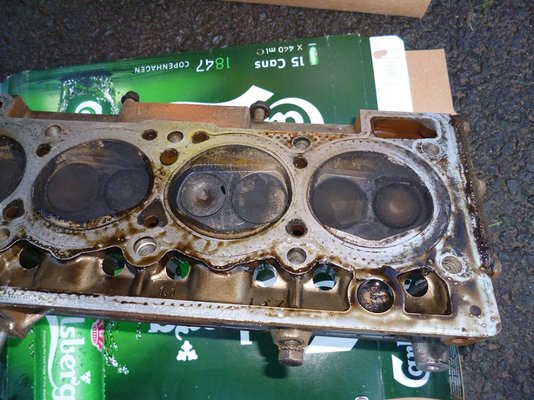

Did some more investigation today. There's no compression on the cylinder so I can rule out electrics. Now suspects include a blown head gasket, burned valve, and burned piston rings - in rough order of annoyance. There's a smell of petrol in the oil so head gasket feels probable.
So it looks like the next step is to take off the head - a first time job for me. Are any special tools or precautions needed? I know about tapping off the head sideways and then clamping down the liners.

Pulling 3 or 4 both have the same significant affect of revs dropping or stalling. I'm starting to think that the valves in 1 & 2 are gone. I will take all 4 out and see if I can feel a difference between the compressions but only have my finger over the hole as a check for now. I'll try tomorrow after work.
It seems as if cylinders 1 & 2 are doing very little work & that all the graft is being left to 3 & 4! If the valves are only slightly damaged the car would probably run reasonably well at speed and only suffer when under load (cf poor running at about 40 MPH in top.) The emissions will be all over the place, too!

Had the rocker cover off at the weekend to check the valve clearances, should be IN 0.15 OUT 0.2, they were 0.9-0.7,0.5-0.25,0.13-0.22 & No 4 was 0.11-0.15. Just received my Haynes book, been years since serious work on cars, is the head off much of a job and any particular special tools recommended? I know it will say in the book but just asking for experienced view.
