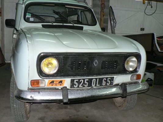

Grill cover fitted
Grill cover in place - 3 mins to fit and works well - have a heater back, just in time for the "big-freeze"

I have still the original grill cover. It's meant for the inside of the grill.
This is the third winter after the car has been passed to me from my grandfather and today I first time installed it.
