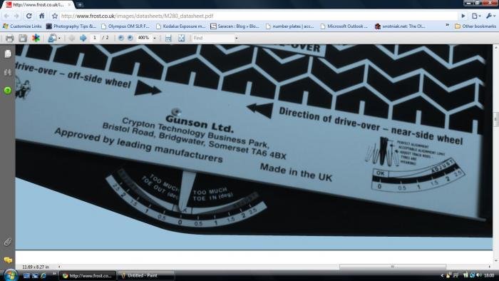

From what I read (unless I misunderstood) it appears that it tells you if the tracking is out, but not by the amount of degrees it is out from the correct figure stated by the maker of the car. For example, if the front wheels are supposed to be 1/16" toe in you can't use this tool to adjust it to that measurement. The only way I can see it working is that if the tracking should be in a straight ahead position then any excess toe in or out will move the plates and so indicate how far it is out.
I could be talking completely out of my backside, so please correct me if I have missed the point.
That does seem to be the case, in as much as it will tell you the angle in degrees that the tracking is out, but not a linear measurement like 4mm.
However, presumably, the degrees indicated are measured over the length of the device, that is, the length the wheel travels when run over the moving bit of the Trakrite. So, if one knew that length and the maximum toe-in, which for the R4's rear wheels is 4mm, then one could either find the maximum allowed measurement in degrees by either calculation or by drawing? And one could do the same for the front wheels, which Haynes also gives in linear measurement not degrees? What do you reckon?
Be a lot easier if Haynes gave the toe-in/toe-out in degrees as well!

But its easy if we know the settings required for our car then all we need to do is adjust them to the correct toe in.
Here's a close up from the Frost user manual.
