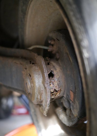

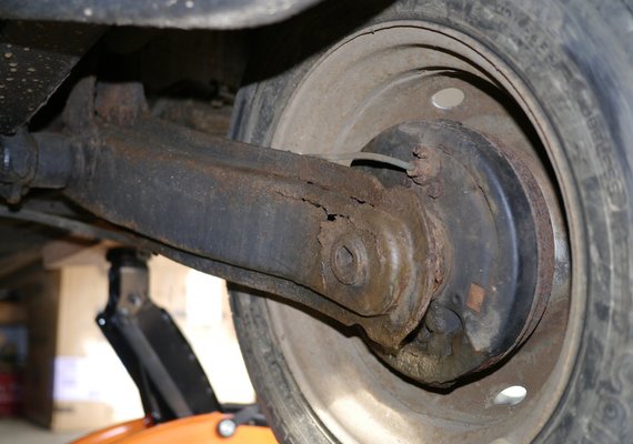

Our GTL rear offside trailing arm has rusted through. The wheel is at an alarming angle and is rubbing on the inner wing! I think there are two types of trailing arm
, but I'm not sure which type I've got and also where you can get them from?
Also, does the drum need replacing? Is there a way to tell which type of drum goes with which trailing arm?
Also, what else would need doing? Would any bushes need to be ordered separately, etc?
My local garage might be able to do it if I can get the parts.
Many thanks for any advice, we want to get him back on the road as soon as possible!

I've also contacted Simon of Renault Reborn who tells me that no one seems to supply trailing arms any more.
Your best bet would be to try to find the complete rear suspension as the link above and change it in 1 piece. The people in the UK with lots of cars in bits that I can think of are alewis, Bobble, Renospeed, Mr Reno,

I've got a complete set of those in stock, but sort of reluctant to sell it.
And I have a complete cast iron axle for you. I can take it apart and put it on transport. with package post.
You can use the original brakes and put them on the new axle.
And while you are at it replace bearings, break pads and pumps.
