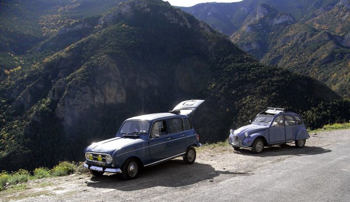

Hi Andy
I live in the Pyrenees and have an 850 and an 1100. Yes the 1100 is like a normal car but the 850 is also OK - more on the descents with the drum brakes more than the going up. My son uses the 850 all the time back and forth from Toulouse (220Km round trip) and he is off Skiing in it today in the mountains with 3 guys and all their kit.
So Cyprus is easy for the little 850 - and as you say, if you find a 1100 engine you can always swap it over. (my 1100 has slightly bigger drums on the front than my 850)
Ian

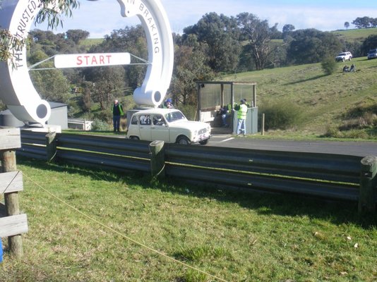

Hills? no worries. Here's me on the starting line representing our local Renault club in the Rob Roy Interclub Hillclimb Challenge in my girl Lucille.
Lucy's an 850cc.
OK, so she's not quick but it's a lot of fun.
Got second in class last time. What a hoot.
