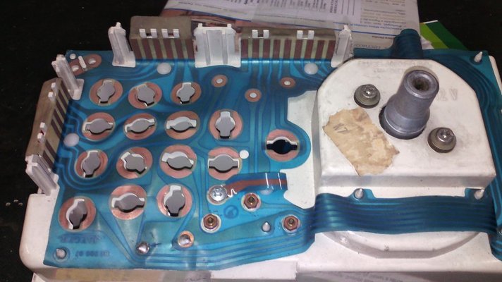

Hello again I one more question, which one is the test hall?
ops typo sorry, hole I meant, I remember to read some where, that one of the holes is used to light up all the lamps at the same time so you can check if all of them work.
Do not know about that.
This is first info for me that something like that exist
After checking in my 3 instruments panels I have to agree with you.but I read that some where I will try to find that info again." My brain is remembering me of this thought., oh I thought the empty places were meant to ad more instruments,but this one is for testing"
