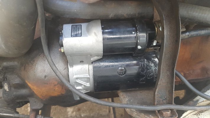

And on a related point.....hoe do I tell the brand/manufacturer of the starter?

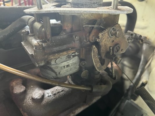

IMG_2524.JPGOur 83 R4 1108cc has started getting a similar problem. Been good all summer but then poor at starting this autumn when it's turned colder and wetter, eventually with 1/2 choke it does start and once going suffering flat spots when accelerating even when warmed up. Today when driving back home it lost power and cut out completely. Waited a few minutes and it restarted, but had to use some choke and keep the revs up to keep it running to get home. If I put the choke in it started nearly stalling again.
It was all restored in 2018 but then sat about unused for years until we got it this summer so have gradually been replacing stuff - fresh fuel, tyres, brakes and fluid, oil, coolant, air filter, plugs, HT leads, and soon to do rotor arm, coil, condenser, points etc but am thinking it could be a fuelling problem causing the recent running problems. It has a Zenith 28 carb, see pic, I noticed a clamp missing off the fuel line so I'll replace that. Perhaps this carb needs a refurb and look at the filters or any air leaks? Maybe some gunge in the float chamber or jets from when it was stood for ages. Just seems odd as it was all okay in the summer months. Can do most stuff myself and have an old school good mechanic friend to help too when needed. We'll get there....Any thoughts appreciated. Cheers L

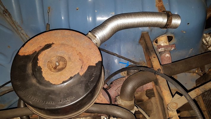

If it's not gunge in the fuel system (quite likely) or an ignition problem, have you checked the air filter hose position? I remember you said that the hose was still pointing forward. It might be worth putting the hose on the winter setting to see if it makes a difference.
