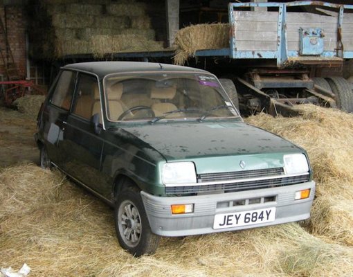

It's a barn find! The TX has been knocking around the barn for a while and I've finally bought it. It's a bit rusty around the edges and needs some engine work, but it is in remarkably original condition and hasn't been messed around with.
That's 3 Renaults now!

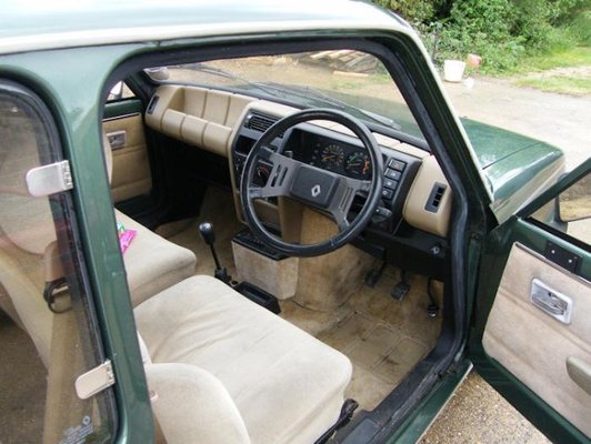

It's got the sporty but comfy interior. Only snag is it smells of dog inside. The only other early '80s Renault I had any involvement with also smelled of dog. Is it the trim materials or were they both owned by dog lovers?
I'm going to try for a light restoration and not get carried away.

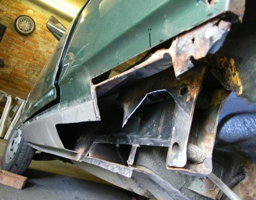

Jet washed the underside in the rain yesterday and it looks lovely under there now. The thick paint/sealant still looks in good condition, but there's not always any metal left behind it.
Work is cancelled until next week so I'll go out and make a start hacking away at the rear suspension mounting.

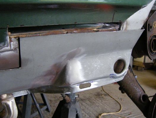

A milestone in the R5 Restoration - I've finished all the welding on the left side of the car! All of the bits of orange primer cover rust repairs (apart from on the door where they are just decorative).
I'm keen to avoid mission creep on this one. There are a bunch of big dents under and on the fold line. The paint is fairly good but it is metallic clear on base coat and matched in repairs will be obvious. Wants a full respray really.
