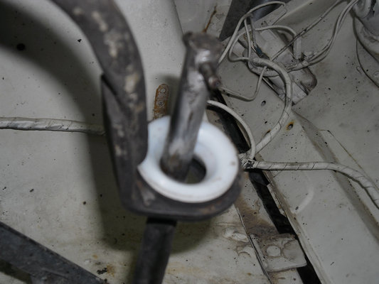

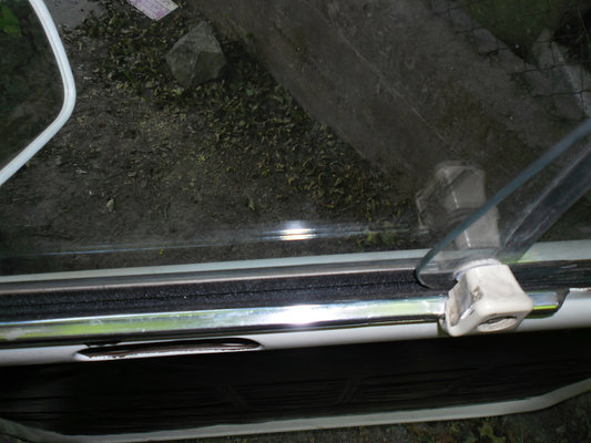

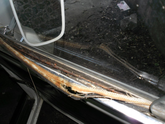

A very BIG thank you to member Angel who found me some new window channel and the gear lever bush kit I needed which have all been fitted today :).........A good day has been had all round as I found all the air leaks on the fuel/carb system ( I think) and now she seems to be running very well :), the rear bumper brackets have been straightened up on the left hand side so the bumper is not touching the bodywork anymore :) .......
Nice one Andy! Can you tell me are window rubbers brand new or second hand and what is their price?
they are brand new I got them from Angel a member on this forum .......he is in Greece

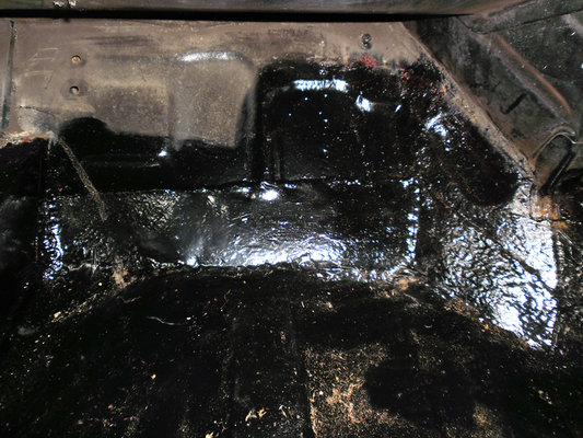

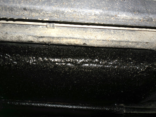

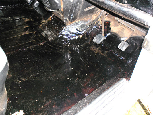

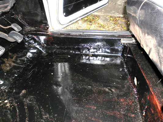

have you any photos of your floor replacement in front? I've just temporarily repaired a hole with fibreglass, but I think later this year I might put in a new floor, but I've no idea how its done. Did you fit it over the existing floor or did you remove the old floor and put the new one in?
Hi mojobaby, I did not have access to the new floor panels you can buy in the UK so I had one made up and cut the old floor out to remove all the rust areas up to (and just beyond the pedals) If you fit it over the existing rusty floor you are just asking for trouble as it will come back over time. Once fitted it was sanded to provide a key for the red lead ( we can still get that here) then double coated with smooth hammerite and the under side then got sprayed with underseal (bodyshultz). Once this is all done you have to (make as sure as possible)it all water tight, I replaced the window channel as the glass was just so loose it was letting in water and also went around the bulkhead inside and under the bonnet and sealed all the holes that are there for cables wires etc to pass through as water can enter the interior via these and collect in the footwells.
If your lucky enough to get the new floor panels you can lay them on the old floor and mark the edges with chalk so you know where to make your cuts to remove the old floor, I had to remove the floor then make a panel to fit !
I will post some pictures today when I get time for you. Good luck with it its a time consuming job but worth it;)
Just looking at these I think I had better get out and give it another coat of Hammerite inside !:eek:
Thanks Andy, looks pretty watertight now. Are the new panels welded to the old panels or did you use adhesive? Looks like a time consuming job, when I eventually repair my floor, I think I'll get the panels from der Franzose
they were all gas welded into place, not too bad really just one day to cut out and replace the floors front and rear divers side and a couple of days to sand and paint them, just took time for the drying time between coats ;)

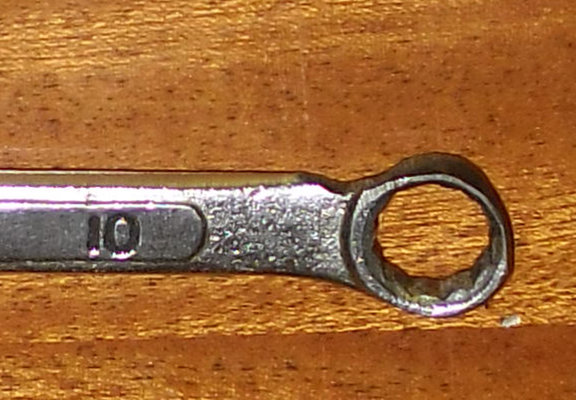

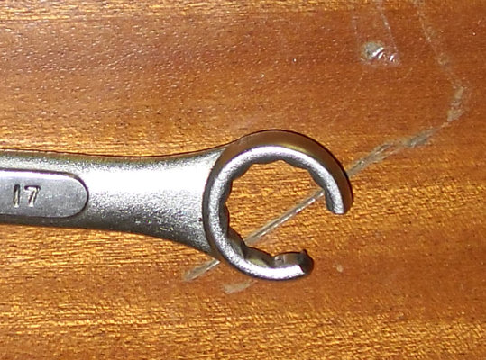

just out of interest how many people have tools like this in the tool box ? A modified 10mm for the rear brake cylinders and a modified 17mm for the front flexi brake hoses !;)
I did the same after messing up one of the nuts at the master cylinder. It rounded off so easily!

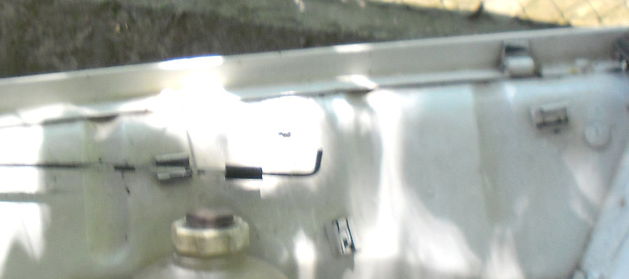

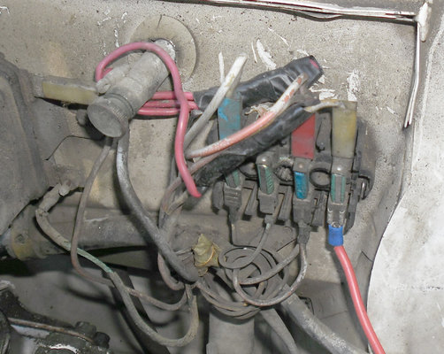

really desperate for some clips if ANYONE can help ?
I need the 3 clips for the inner wing to hold the jack handle and the small one for the bonnet support arm
Also a cover for the fusebox ......all costs and shipping paid if anyone can supply some or tell me where they are available please
