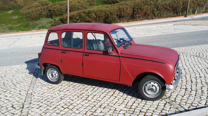

Hi all, i need some help with a loud squeaky noise from the front end / suspension .
i can not find where the origin of that noise is? any tips on that ?
