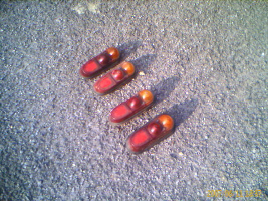

hi jan as im on pc will let you know that its good news and bad have found 2 lefts new (part number 7701007750)in box and one right s/hand how ever ns rear has been broken on mine so need one my self and would obviosly like to keep a spare myself particularly if no longer available

just tried to send pic via pm (cant be done)after failing to send pic from phone
just to prove they exist heres proof
let me know if new parts coming from france still

Amazing!
That's incredible! isn't it strange so many at once. And in answer to your question, yes, they're still sending them new from France. George Thomson is fantastic. He's so efficient.
