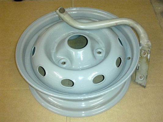

Blanche's wheels look great! The Hammerite top coat you used looks like a good finish. I used Hammerite anti-rust primer (brushed on) on the wheels, but found it very difficult to get a smooth finish and hard to sand out the brush marks. I then sprayed a coat of Plastikote silver. The wheels are not perfect, but they're a lot better than they were.

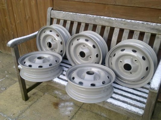

get some Beige P36900ing.I was planning to do wheels and bumper with the same paint.
They do look better in the day light.
I also thought about getting the new paint mixed with a Satin Finnish.
