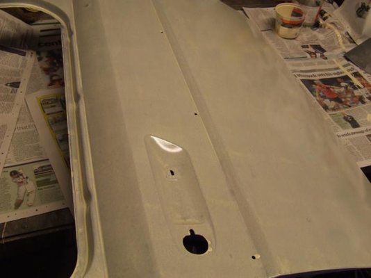

Just a quick report of my success with this technique.
As I suggested, I have taken a door, previously prepared and primed and applied the roller technique, using the Combicolor with approximately 10% thinner and a dense foam gloss roller.
The paint went on quite easily, with a second light rollering to take out any bubbles. The first shot shows the initial coat, good and even, but with the primer still showing through.

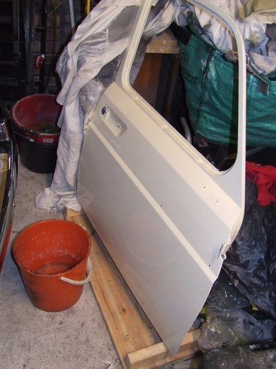

After flatting and two more coats, the second shot shows the result straight from the roller. Colour is solid and already has self levelled to give quite an acceptable gloss. The bucket is positioned to indicate the level of reflection, although the light colour does not show this off terribly well in the photograph.
I estimate two more coats and then a good flatting and some TCut will give a very acceptable gloss finish. If you are going over sound paint and arent changing the colour too radically, then three coats will probably do the job.
It is worth doing any awkward corners with the brush initially, to get the cover, the roller seems to blend it in quite well. As a further experiment, I carried out a brush finish to the door insides, using a good quality gloss brush, and this again has produced a fine full gloss finish, brush mark free and will have given full cover after two coats.
Final finish is handleable after around four and a half hours on a warm day, and dried to a good hard finish, sufficient to be flatted, after 24hours
If you are doing a fairly radical colour change, it is probably worth considering a base coat of aerosol primer, just to help kill the old colour and to cover any bare metal areas that your prep has revealed, albeit the paint is supposed to be self priming. It will also help with the final stoppering of any minor blemishes.
I propose to do final coats over the next couple of days and will post further pictures of the finished item. At the moment, I am impressed with the finish obtained and consider it to be as good as, if not better, than a low budget spray job, with only a fraction of the hassle and cost.

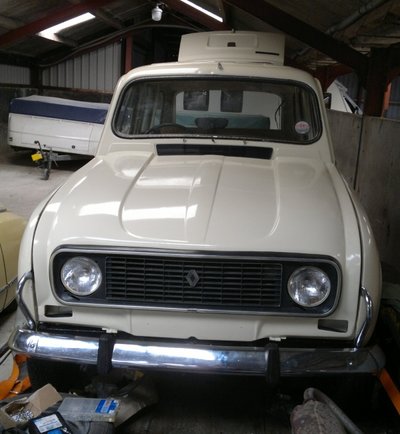

I have now painted the whole car, and the effect from the roller is good, with only a few blemishes here and there. I shall flat and polish these out when I have finished reassemby and touched up a couple of small battlescars that have arisen.
My general feeling is that this is a good way forward if you don't want the cost or hassle of a full blown respray. It has taken approximately 3 litres to do the car inside and out and I have used aerosol primer whilst pepping bare metal areas and eventually to kill the old colour. If you were going for a similar shade, then the latter step would not be necessary and you can simply rub down, degrease and paint straight onto the old finish. It isn't cellulose based so you shouldn't get a reaction with the old paint.
I'll post some more pictures when I have finished the car properly and polished it up.
