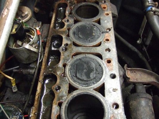

Hi first for me burnt 2n3 pistons,took head off my 67 ol 4 thinking it was valves did compression test 85 to 3 not good,head off slight damage to head,so looked into engine,could not be mice,something had been eating piston crowns.To rich mixture petrol to air,I tuned car,soon after purchase obviously to late,never mind. Can anyone advise on pistons availiability someone mentioned bmc is that a poss,renault mad thought he had heard that that was a cheaper option,ears to the ground buddies,thanks.AL

Those pistons look OK to me from the photos. Plenty of carbon on them fair enough but that comes from the petrol when it's running rich. You'd need to remove that carbon to see any piston damage. No reason to replace pistons unless I'm missing something - is it melted pistons not carbon I'm seeing?
You get a bit of carbon on top of pistons especially if the engine has been running a bit rich (poorly set up in the past maybe). You could scrape it off but be very careful not to put any force on the liners and definitely don't turn the engine over as the liner seals at the bottom will pop out and will need to be replaced.

It must be one of the very early timing chain engines (duplex chain maybe?) because I see the early distributor clamp fixing. And these pistons should be 54mm (747cc) as they have the hump on the crown.
Are these tiny gaps at the piston circumference broken off the piston, or just carbon deposits chipped off?
