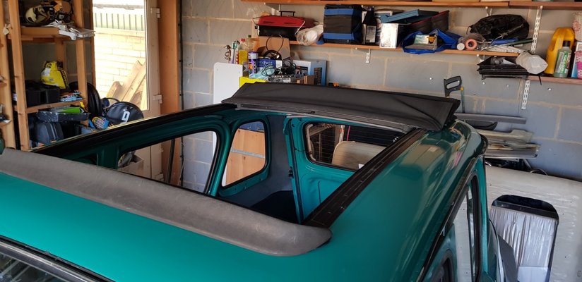

Thanks Edwin - my R4 had a poor after market sun roof - unfortunately roof lining cracked clean when I tried to remove it. I have had a response from a fellow enthusiast who might have a spare. I had already thought I would have to do a repair job so thanks for the good advice. Here is the replacement sunroof (Twingo). Wouldn't have dreamt of doing it - but R4 already had a ghastly hole - so I do feel that I am improving it.
You can just see the lining at the back and the size of the original hole!!!
