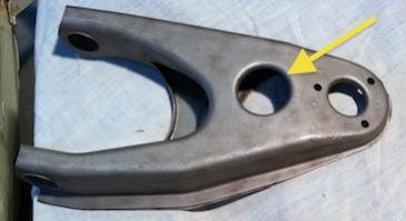

The wishbones are the same on both sides but can't say if the top and bottom are from the same type ( how to recognize them ???? ) I know the rear suspension is the newer type.

The early wishbones have a hole in them that the later ones don't - see picture.

I am not sure ( and I'm not going to garage coz it's minus 15 celsius degrees ) but I think mine don't jave those holes. If so I will be leaving them the way they are. I need the car to be 90% orginal because of legal possibility to register it as a historical vehicle but specialists who write certificates that the car meets standards and can be historical car ( different reg. plates, no MOT every year and ability to buy insurance for short periods only ) don't check detail that are under the car so badly. No one will notice newer suspension.
