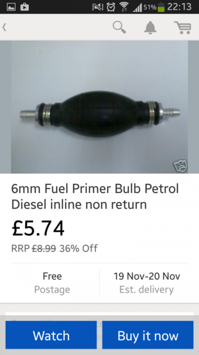

Shame there isn't some kind of priming device you can fit.
