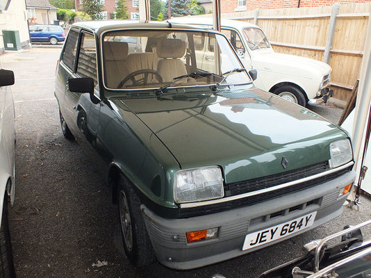

I took the Renault 5 for an MOT this morning. I decided half of the things still to sort out were due to the car sitting for the last 6 years, and the car needed to be driven to see if they would go away. Most of the problems have gone away or improved.
I think the gearbox noise was simply gear rattle due to hunting at idle. I'm going to try to fix the hunting instead of changing the gearbox. The car feels a bit lean on part throttle and the secondary choke jets keep on blocking and it might all be related. More likely all different problems which will make fault finding more tricky. I've filled up with 99 octane (Tesco are doing it and it seems to work) which has helped a fair bit.
The ride and the seats make it feel like a big car to drive - really comfy, but the cornering feels flat and the steering very precise. I don't know why modern cars can't do that. My custom exhaust is way too loud. Booms on the motorway.
Not too much to do before it becomes a useable car.

I've been fiddling this morning. The hunting at idle was due to petrol dripping from the primary choke jet onto the top of the throttle butterfly. It was doing that because the idle mixture screw was screwed fully in. Idle is perfect with the screw 1.5 turns out and the popping on over-run has stopped. The secondary still keeps blocking despite a good blow out with an air gun.
The exhaust mount touching the wheelarch liner accounted for a lot of the booming. The foul between the air filter and bonnet stay and the failed cold air/ hot air flap didn't help, but oddly removing the cold air hose helped more. It might be better with a porous cold air hose.

I'm getting to the bottom of the exhaust boom. There isn't enough space at the back to have a long enough silencer or tailpipe. Improved a lot when I attached an extension to the tailpipe but I think it needs another silencer further forward like they originally had.
